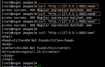

含正则表达式的location指令,实例一:
server {
    listen 8081;
    server_name 127.0.0.1;
# ~ :用于表示当前uri中包含了正则表达式,并且区分大小写
# 正则表达式:区分大小写,以/abc开头,以1个字母或数字或下划线或汉字结束的
   location ~^/eee\w$ {
        default_type text/plain;
return 200 "access success. 000 Regular expression matched: eee  \n\r";
# 能匹配到:
http://127.0.0.1:8081/eeeb
http://127.0.0.1:8081/eeeB
http://127.0.0.1:8081/eee2
# 不能匹配到(大小写区分):
http://127.0.0.1:8081/Eee
http://127.0.0.1:8081/eee/
http://127.0.0.1:8081/eeedef
http://127.0.0.1:8081/eee/def/
http://127.0.0.1:8081/eee?p1=TOM
如图:
